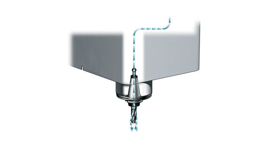

The M88 code is used to turn on the through-spindle coolant (TSC) option, an M89 turns the coolant off.
Proper tooling, with a through-hole, must be in place before using the TSC system. Failure to use proper tooling will flood the spindle head with coolant and void the warranty. Running an M04 (Spindle Reverse) command with TSC on is not recommended.
Haas cnc through-spindle coolant system (TSC)
