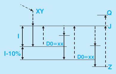

G83 [X... Y...] Z... J... I... [Q...] [K...] [F...] [D0=...] [D7=1] [D8=...] [D9=1]
Selca G83 Deep drilling fixed cycle with tool retraction for chip discharge
ParameterDescription
X,Yhole coordinates.
Zhole bottom plane.
Idepth increment prior to (tool) return for chip discharge.
Jhole starting plane and tool retraction plane for chip discharge.
QZ-axis clearance plane.
Kdwell time for cheap breakage at the each increment (in tenths of a second).
Ffeed rate.
D0=when descending after a chip discharge, tool rapid move changes to the programmed feed rate at a distance of D0 mm from the previous depth.
D7=1tool retracts to theQplane for chip discharge.
D8=scaling factor for rapid positioning feed (value include between 0 and 1;D8=1 by default). (Only for S4000 CNCs).
D9=1never mind where the machine is, the cycle is execute in XY position, without to programming XY (D9=0 by default).
Enabled: until a new fixed cycle or a G80 is programmed.
